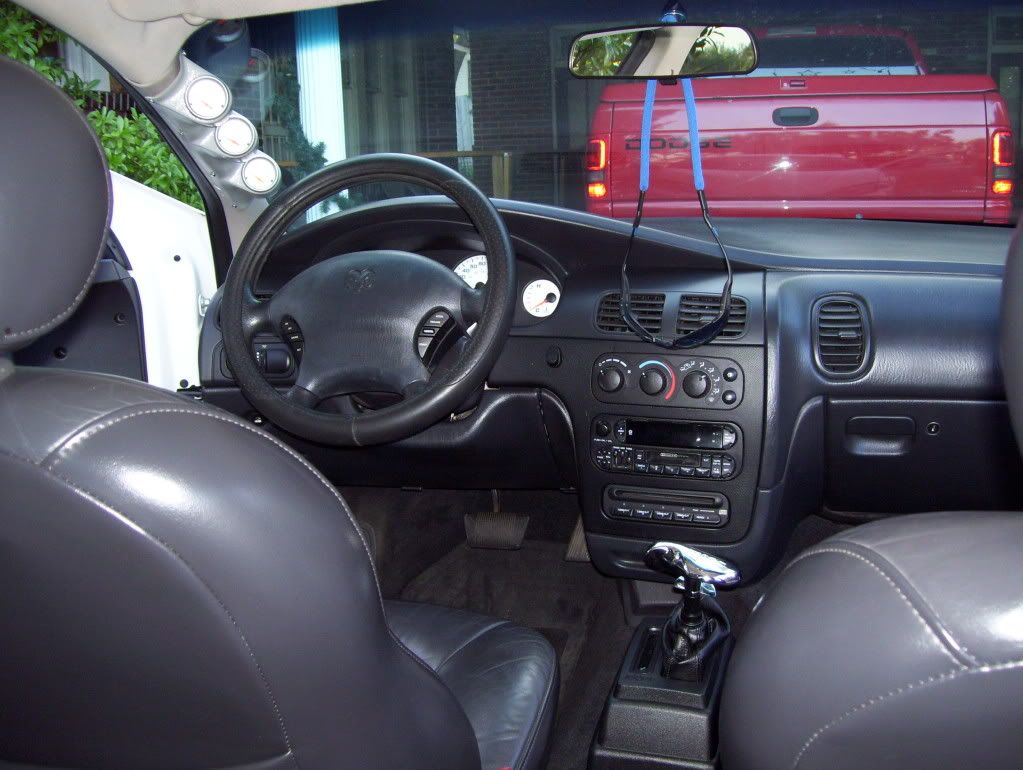

Well, i finally took the plunge, and being tired of working on the engine and drivetrain, decided to do the interior work and shifter install before going back to tuning and tweaking the stroker. I got the power leather seats out of a nice 300 installed, and decided I wanted to do something different than the OEM center console. The car started out with the column shift, which has gotten quite boring by now. So, I decided to install the B&M Hammer shifter. It not only fits, it works, and it looks and works great. I like it way better than an autostick. I contacted Hurst and B&M both to make sure it would work with our transmissions, and they are virtually the same as a 727/904, which is what most aftermarket shifters are set up for. Had to tweak a few parts, and use the Ford pan bracket instead of the Mopar one or the stock one which was considered. Also, instead on running it up the firewall and out the stock hole, I drilled thru the floor right below the shifter and ran it under the trans tunnel. My only concern there (and if you've melted a shifter cable on your headers, you know where I'm coming from!) is the heat but theres a good 5 or 6 inches betwen the cable and the pipes. So without further ado, here's a few pictures of the new shifter. I love being in control of the stroker monster, the ratchet shifter makes shifts sure and fast and just a bunch of damn fun!
Here's a few pics, I wil get more up tomorrow. If anyone want more details let me know and we can get together and git er done.

That looks fantastic nice job!!!
Do those shifters work like a regular automatic or is strictly manual control?

Thank you all. It works like a regular shifter in that you can put it in drive and let it shift on it's own, or ratchet it back to low, shift to "3" which is second, and then it will upshift to third when it hits the shift point. If you hit cruising speed and want to allow it into overdrive you ratchet forward to "D" and you are good to go. It has a reverse lock out to keep you from overshifting into neutral or reverse, you pull the spoon lever up in drive and it slides forward to neutral, reverse or park. Same thing coming out of park, you have to pull the handle. Once I get the trans built, it will really come into play as I will get a lot more bang out of the trans when it shifts, and doing it one click at a time will be a thrill.

Very nice. You don't have the control that you would on downshifts that you would if you had autostick, right?

Thats correct, it's the same as if you had a regular floor shifter, drive, 3 and low, and it won't down shift unless you are on the throttle and it kicks down.
