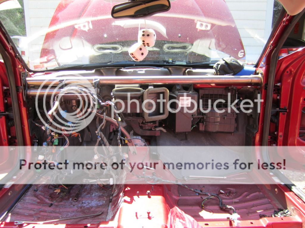

The motor really has nothing to do with it. It what your car has to run the PCM properly. I wanted mine to be factory correct with no splicing, so I had to replace the dash harness with one that had the SKIM pigtail. If you dont have SKIM, then its not just a matter of plugging it in. The easiest way to do it it to have all three matching items. SKIM, PCM and key. Then, if you have SKIM already, its just plug and play. After I did every thing, a year later I had to test a Special PCM for a member on here and it took me 14 minutes to swap the hardware.
