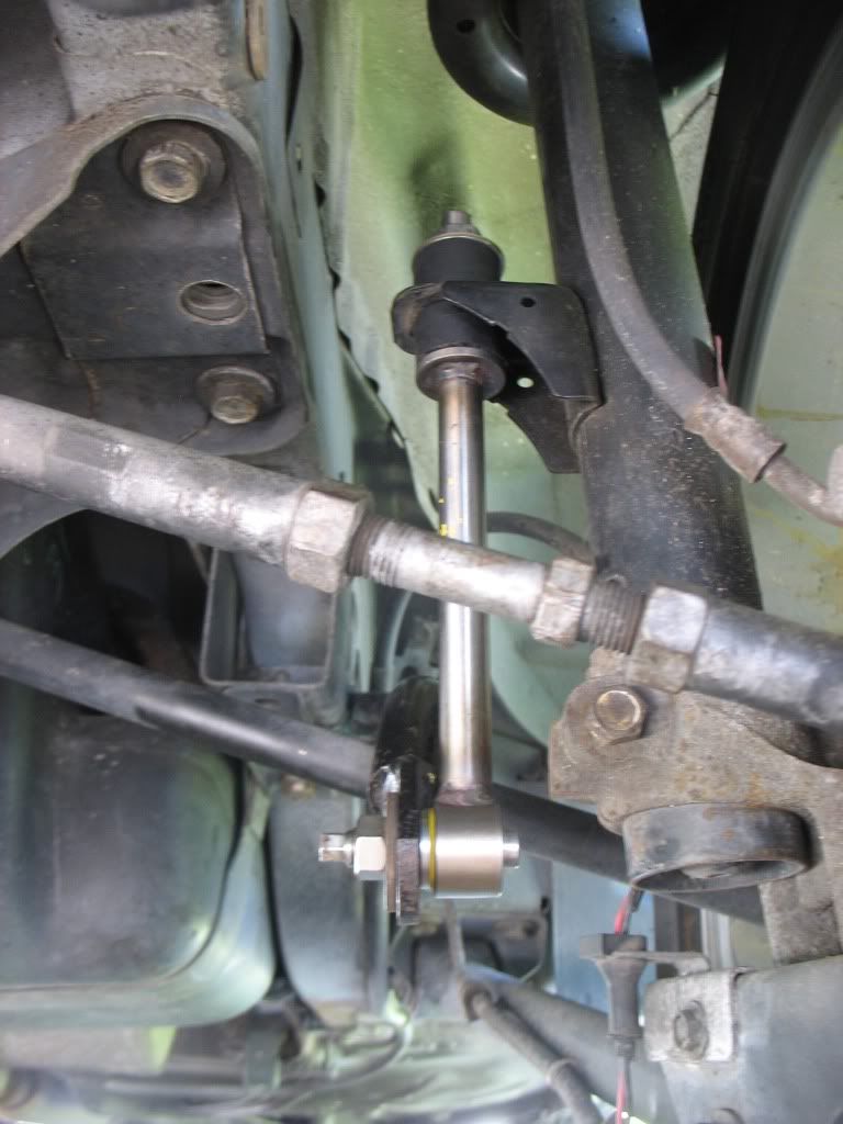

Originally Posted by Intrep_ED
Well done fix Andrew!
Looks like barnacles growing on that strut lol
Oh and Moog FTW!!
Yep!
Happy Birthday by the way Ed.
Originally Posted by EagleESI
Yeah, I heart Moog for alot of things. There was talk at some point of Autozone carrying it. I hope it comes true. I have front Moog sway bar links, the cheapy advance ones I originally bought never lasted, these moogs are several years running now.
Of course, don't think even moog has much on my sway bar links for the rear.......(also andrew, take note of how my bushing is. As I had mentioned earlier being squished like that will shorten their lifespan way way way much more.)
I already loosened them. That's what I get for going by the torque specs on a Haynes manual. It called for the small link to strut nut to be torqued to 75 ft-lbs! That's more than the torque spec for the much larger link to bar nut. I never did make it that tight. A check with the FSM confirms that it should only be 17 ft-lb!
