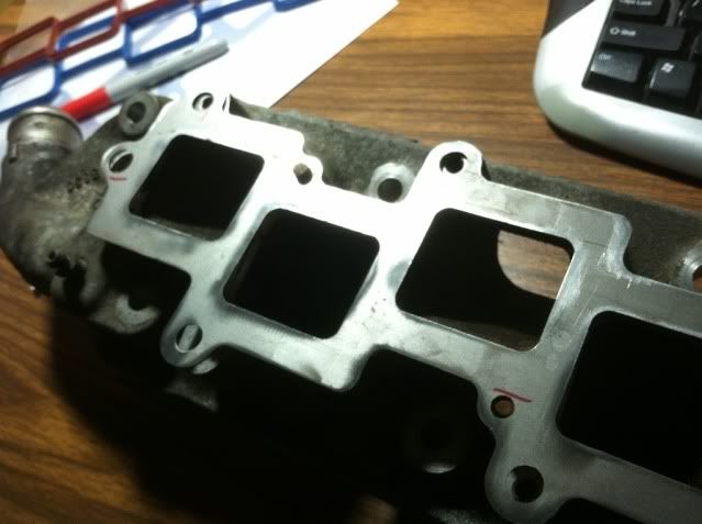

Good News! Prototype has been machined! It should be here late this week to early next week. This is only 1/8" and does not include the groove and is to measure up the holes ONLY. However you can see how the outer walls have been thickened up a bit to compensate for the groove. This way if you decide to throw yours on the garage concrete, it will be less likely to chip or crack.
Hopefully my measurements hold and we can jump straight into full production next week! Hopefully. I feel like there may need to be slight alterations. More pictures to come later this week!

Looks pretty good at first glance.

The critical areas are pretty much dead on from what I can see, the rest are just cosmetic. If I were you, I'd do the changes to the design to get them closer to the original spacer and then just send them to production. Even if they are a bit off afterwards it's no biggie, at least they're closer than before.

What I can also do is get a print out of the spacer at 100% scale. However, I can only access about 60% of the spacer this way as I only have the ability to print 8x10 paper. I can't figure out how to print out half and half.
I will adjust those areas that are of slight concern and get one full scale made and install that on my car. When everything is a go. I will make 30 of them for full scale production.

I've reversed engineered many items in my Machinist career and that does not look bad at all. Remember, your laying a copy on top of a copy. Have you placed your prototype on top of a real LIM? Seems to be the way the plenum and LIM match up with clearance for the coil packs are very forgiving.
Looks good & you are doing a great job on this spacer plate.

Thats a very good point actually. I have a spare LIM from the parts car and I threw the V2 spacer on there and it was slightly difficult to install. However, after moving and wiggling it around I got it to seat properly.
When I wen't to put the prototype on there, it was a no go. I could only get the top two holes to go through the pins. The lower one (as shown in the picture below) is too low and doesn't fit properly.
This is really strange considering I can fit all three bolts in those holes and the spacer fits fine matched up to each other. Even in the pictures you can see there is hardly any noticeable overlap. What I may just do is move that lower hole that won't line up and see if that fixes things. I'd really like to be able to print this out at home and line it up with the V2 spacer but unfortunately not :/

Very Minor Adjustments Made! Prototype #2 getting made and shipped next week! Good progress so far guys.

Prototype number 2 arrived today. There was a slight delay because the water jet was down for a few days or so and things got backed up. Lined it up and I overcompensated for the peg hole. I increased the radius and adjusted the location for one last run tonight. Just sent the email off for the first full scale model! I should get it within the next two weeks and then I will install it and give it a test. I think I'm going to throw it in the special for now since my M has the EGR equipped. However, if i can get the first modded EGR tube done I will install it on my personal M.
