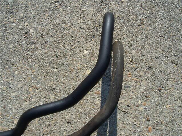

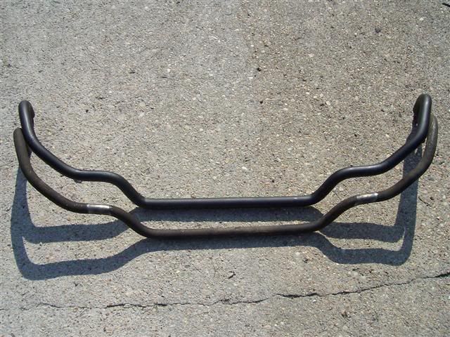

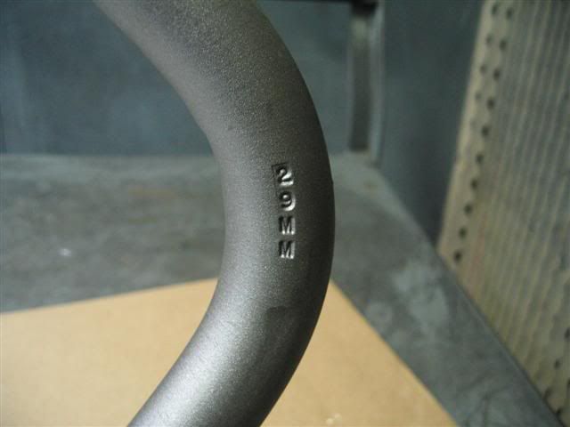

Background on the 300M Special Front Sway Bar:
The factory sway bar is ø27mm and the Special is ø29mm. The 2mm difference may not sound like much, yet the torsional stiffness raises to the 4th power, hence a major increase. The torsional stiffness formula is J = [(Pi/2)*r^4] where Pi=3.1416 and r = radius of bar. So if a ratio is set-up with the ø27mm in the numerator and ø29mm in the denominator, you get a 24.84% increase in torsional stiffness!!

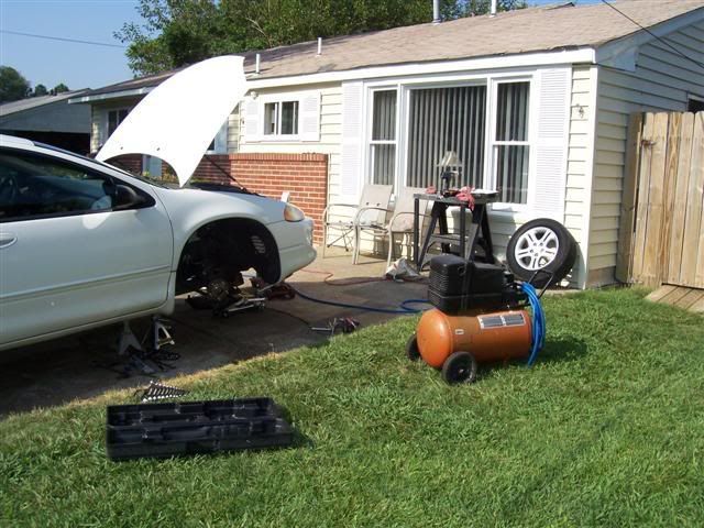

I did this job in the driveway, using air tools and had the front sway bar out of the car in 1 hour 15 minutes (included pulling ALL the tolls out from the shed). If you have a garage with everything at hand, 45 minutes (tops) to pull out the front sway bar. It was not a hard job, only the passenger strut has to come out, two people are not needed and the results are WELL worth it.

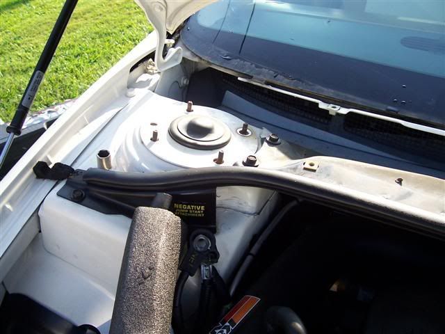

Remove windshield covering on passenger side.
Remove 4 nuts on top of strut tower

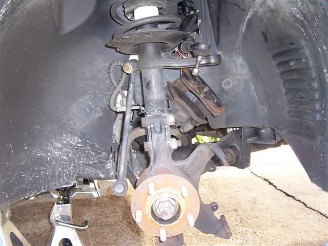

Jack up car, support well, remove tires

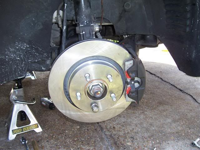

(Optional: Remove brake caliper and rotor on passenger side, support caliper)

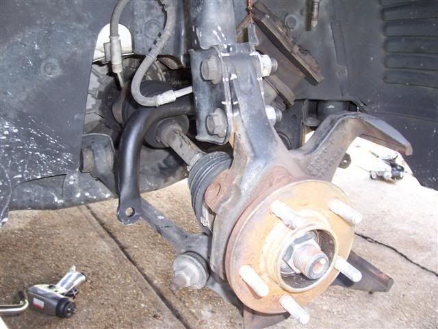

Remove stab bar link on top of strut (18mm wrench, 10mm wrench)
Remove stab bar link on bottom of stab bar (18mm wrench, 10mm wrench)
Remove tie rod end (16mm wrench, 7mm wrench) use brass hammer to break free

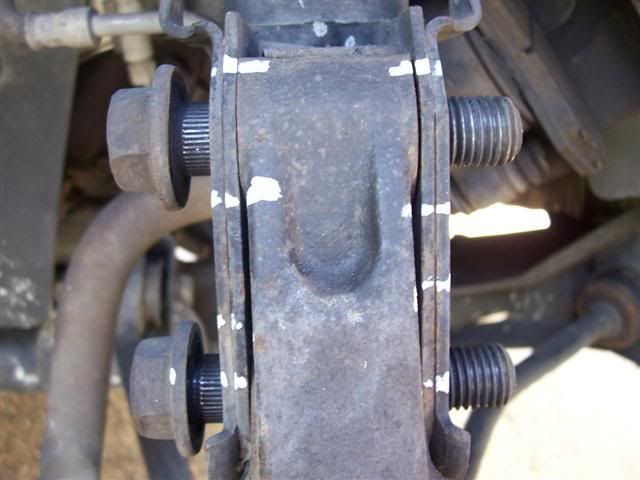

I used a white dye marker for strut alignment marks
Remove NUTS only from two strut bolts (24 mm)
Tap out bolts, you’ll see the serrations on the bolts
Remove strut from car
SECURE HALF SHAFT TO PREVENT THE AXLE FROM PULLING OUT
(I used wire)

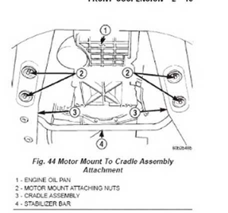

Remove 4 nuts from engine mounts (15mm deep well)
Remove 2 mounting bushings brackets from each side (15mm)

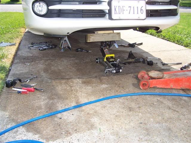

Jack up engine until TB barley touches hood, use a wood block under the motor and common sense. Don’t force the engine up!!

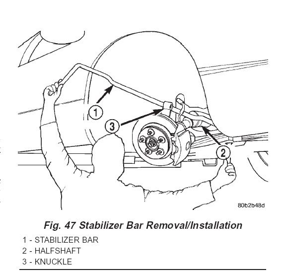

Remove bar by rotating it, routing in front of half shaft and behind knuckle.

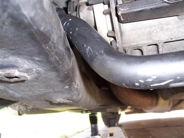

CENTER STAB BAR USING ENGINE CRADLE AS A GUIDE!!, underside of motor
(I used a dead blow hammer to get it centered)

Install strut, (realign using white dye marker alignment marks)
Install 4 nuts on top of strut tower
Install two strut bolts: Again, tap bolts in, TIGHTEN NUTS ONLY

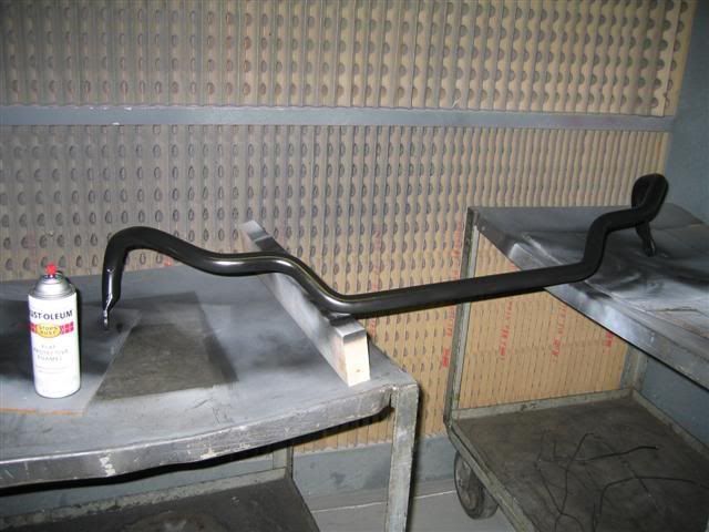

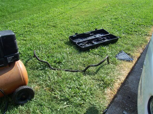

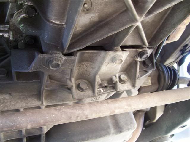

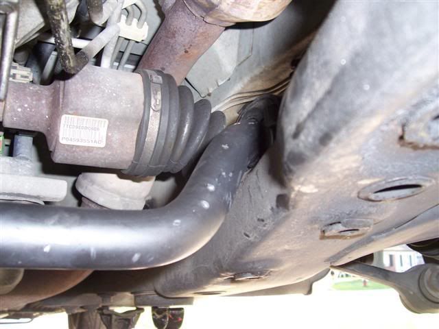

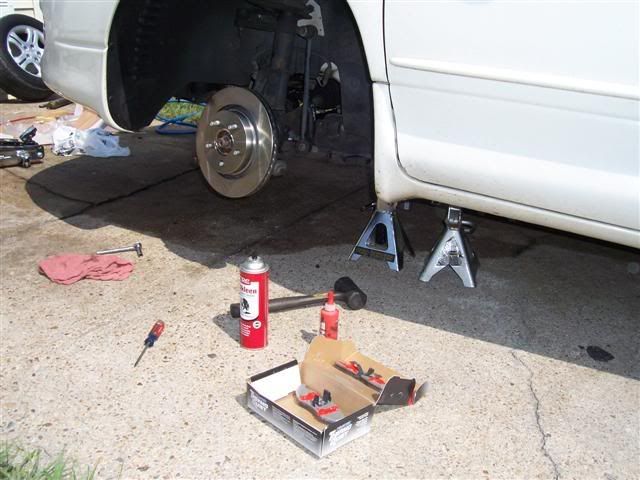

Pictures!!!
Use the pictures below with the instructions above. I didn't feel like putting a description with each picture...

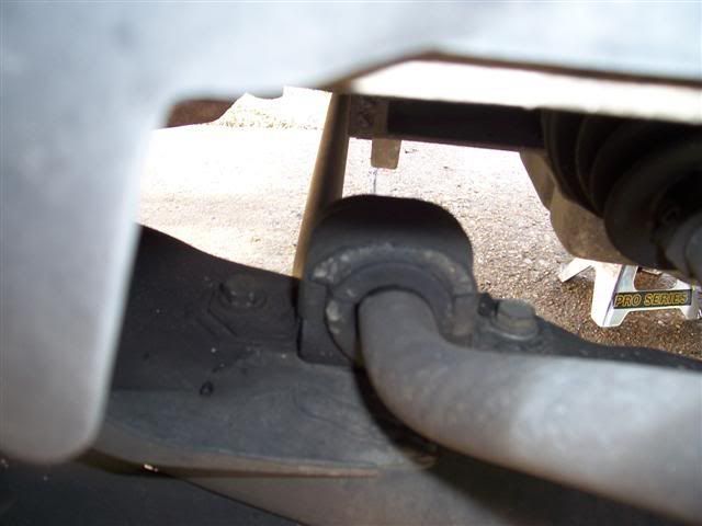

Please note: there IS clearance between the bar and frame..
