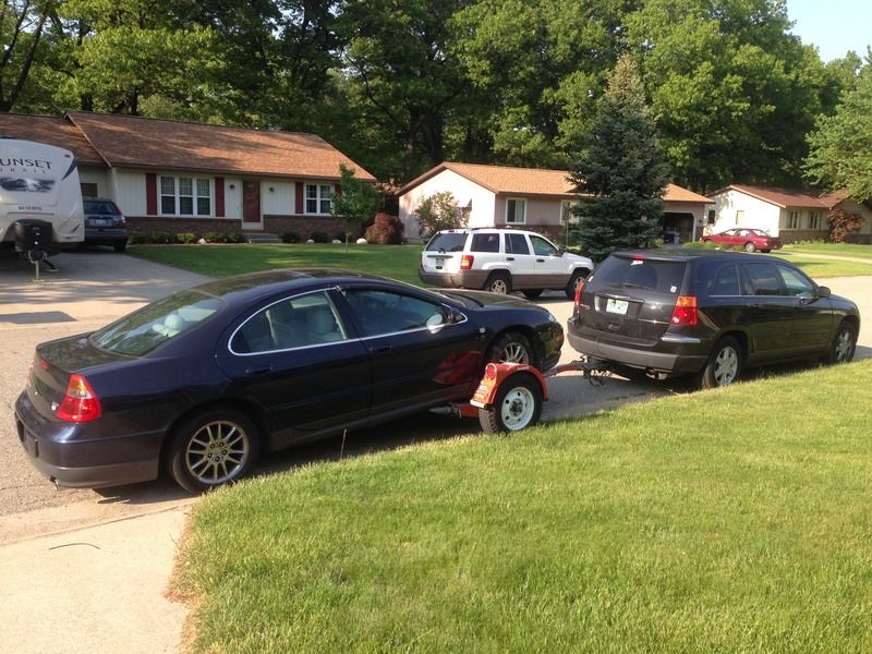

Picked this car up for $500 intending to part it out, has ~195K on it, and the timing belt broke at highway speed.

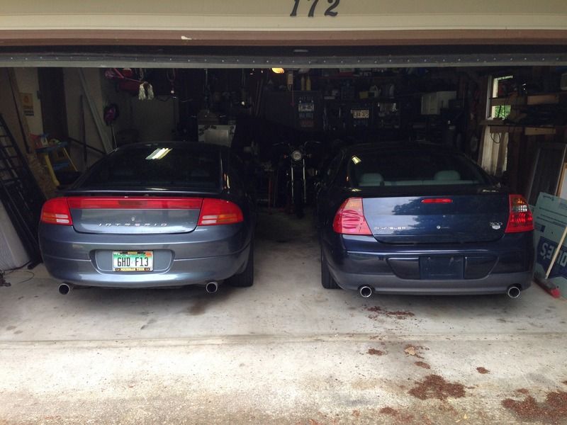

...but when I saw it... it's in wonderful condition. It's really too nice to part, so I'm attempting a resurrection. Thus my LH ownership direction is in question, as I have no room for two aging family sedans. Possible scenerios:
1. My rebuild attempt will fail, and the 300m will get parted; may find out the car has gremlins or something wrong with the bottom of the motor.
2. 300m returns to life, I like it and the Intrepid gets de-contented and sold.
3. 300m returns to life, I don't like it and it gets sold.
So we shall see!
