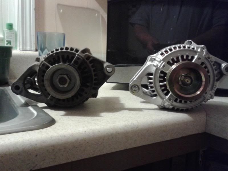

For those wanting little more amps outta there alternator you can pick one out of a 97 year range Dodge Diesel that puts out 120 amps. Brand new its the same price at Autozone than the stock unit to boot.
Bolts right in, requires slightly longer belt and minor wiring harness modification for the field wires. Right now I can't say there is any difference besides the rpms don't drop when the fans engage on high.

Nice find, I'll keep that in mind.
The 136amp on my 3.3l is off a ram diesel as well. I had to add the field coil plug but the belt didnt need changed.
