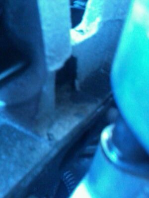

i think i found why my car idle is rough..... i re moved the egr to clean it .. and when i took the egr off i saw the intake was broken is not big ... but i think is sucking air from there....
do i need to replace the whole intake or theres a way to fix it?

That looks like a big hole. Are you sure its broken and sucking air? While its running spay carb cleaner at the hole, if its sucking air it will bog.

Looks like part of the casting to me. I would verify it is actually an open hole in the intake. It would be idling at 3000 RPMs if it was open to the manifold.

soo that hole is normal.....????i will spar carb cleaner and report back........ thanx guys for ur help

Yeah, that happens alot, it is a result of casting the intake. It does not go into the airflow chambers, trust me, if it did, your idle would be 3000 RPM.

you are rigth !!! i spray carb cleaner and nothing change... any ways i have check everything... engine vibration still with engine off.... i can feel the engine stumble .....
i think when i turn on the ac the rpm goes up to 700 800 rpm and the stumble disappear ..... weird....
this only happen when car is in idle.park or drive,reverse..... car is very smooth when driving..
