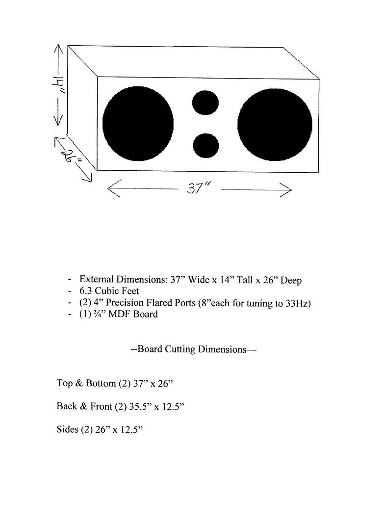

I am going to be building a new box/wall this weekend but I want some opinions on it, The box I have now is 34Wide x 14Tall x 24.5Deep and the new one will be 37Wide x 14Tall x 26Deep - Hope it fits(fingers crossed) I have messed around with my curent box and it is loudest with the subs facing inside the car, I dont realy know how to make it an air tight seal off from the trunk though since the hole isnt squared off like the box , the top and bottom will be tight but the sides will need something done to them to seal it off.. Has anyone built a wall for there trep in here? got pics or demensions? Heres the box I am going to build:

so, which are you building? a box or a wall? and which holes are you talking about not being squared like the box?

Im building a box and the subs will be facing the inside of the car like a wall, the box is square but the hole/trunk opening isnt square so I will have to find a way to seal it off from the trunk. There is a better way to explin it im sure but im tired and cant think... :sleeping:
Edit: The top of the box will fit tightly up against the top of the trunk and the bottom of the box will fit tightly up against the bottom of the trunk and the sides of the box will fit pretty tightly to the sides of the trunk BUT the sides are bowed out a little bit SO it wont be air tight sealed off from the trunk... Hope that is a better explanation...
72 Posts
oh ok, i see what you're saying. you want the sealed area inside the box and a sealed area in front of the subs facing the rear seat... you can maybe cut a piece of wood or plexi to fit the bowed area and mount it on the sub box or something, or maybe you can get by with stuffing the bowed area with some type of cloth or material that you can pack pretty tightly or you can put a string through a piece of appropriatly sized styrofoam and then put it in place in front of the sub box, put the box into position, then pull the string taught and tie it to something....i dunno. i'd prob be able to come up with more inspired ideas if i could see what you were talking about...it's late, i'm tired

Just outta curiousity...why the ports?
I might be building a box simular to this...but Id be looking for quality over SPL. Would I be right in saying, that a sealed box would be better for quality...and if you wanted more lower harder hitting SPL kinda stuff, then you would add the ports?

3,552 Posts
Thanks :)
Good looking plans! :)
--Gorm
I think you are correct.
