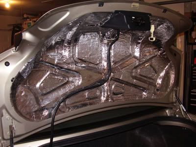

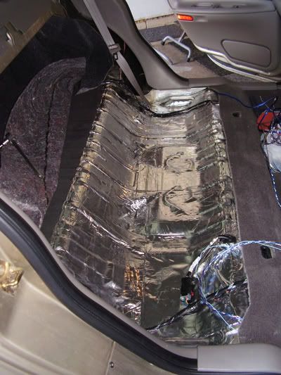

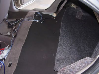

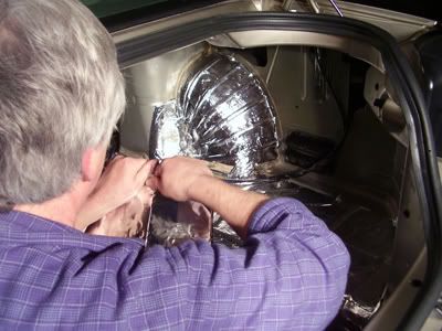

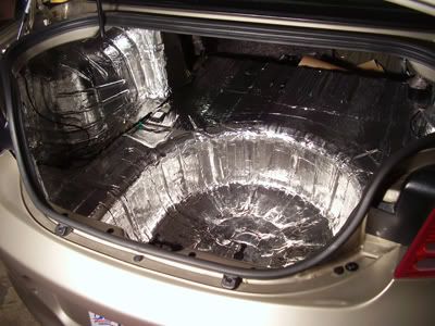

Ripped out the back seat, and trunk to put in damplifier today, the trunk lid was done yesterday. I used 32 sq for the trunk. Also used ~ 30 sq of closed cell foam (also from Second Skin) on top of the damplifier. (the black stuff)
See http://www.dodgeintrepid.net/forums/showthread.php?t=77620 for much better pics.
The doors get done tommorrow. Took it for a drive when I got it done and to be honest.... it sounds like a morgue in the back. :)

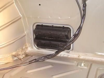

Anyone know what this thing is??? Just curious.... looks sorta like a dryer vent. :biggrin:
2,258 Posts
Dunno what that is, but I had one in my GP too. I took it out because it was the only thing in the trunk that was rattling with each bass hit, lol. Looks like you did an excellent just Dudly, keep up the good work! What ya puttin' back there?

the black thing in the trunk is the vent to keep moisture out of the vehicle. it should have some rubber flaps that when you have all the windows up and the heater on high that should let air flow threw out the vehicle to keep condensation and moisture out of the trunk
