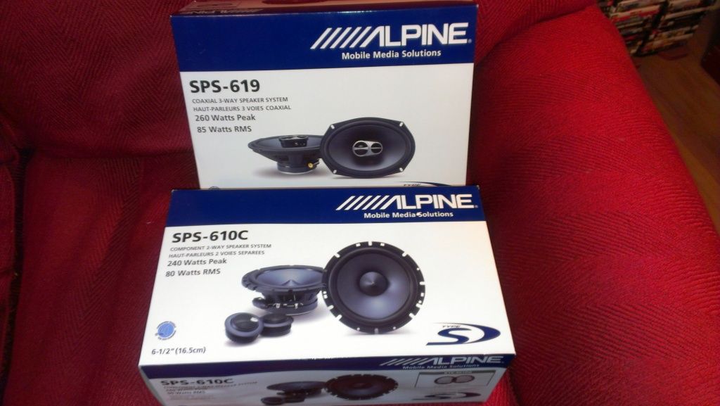

I am going to run Alpine SWS-610c 6 1/2" seperates in the front and Alpine SPS-619 6x9's in the rear.

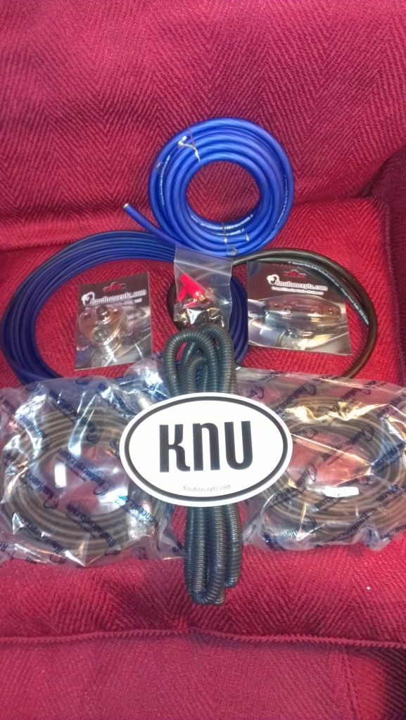

Lastly, for now anyway, I just received my wiring from KnuKonceptz.
