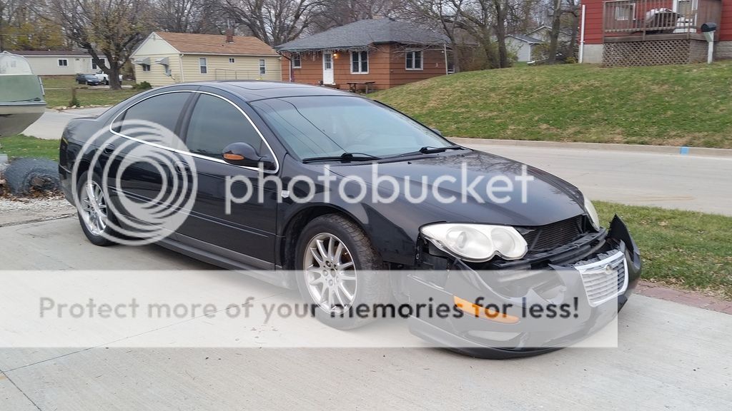

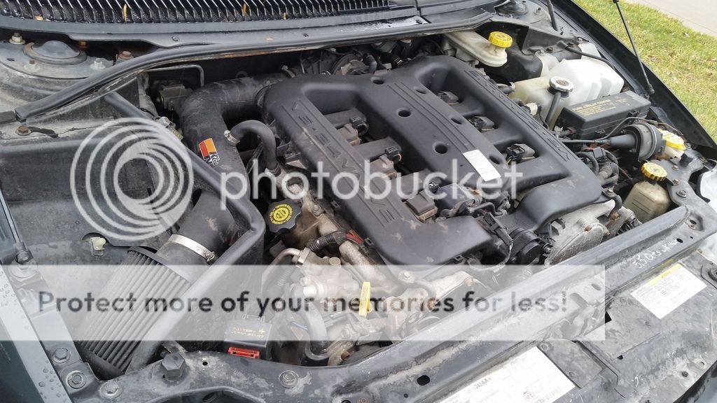

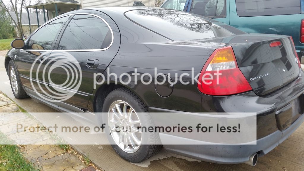

Found a 300m Special on craigslist. Was advertised as good body, good interior, bad engine. The story goes that the owner had noticed a light knock and continued to drive the car "gently" around the Des Moines suburb. Car started running like crap and died. He got it started back up and pulled it off to the side of the road. When we loaded it up my brother tried to start it. It fired up and squealed like hell. Exploratory surgery is planned and I expect to get it back on the road one way or another. Progress may be slow since its getting closer to winter.

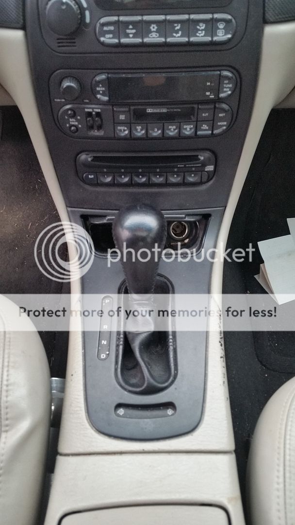

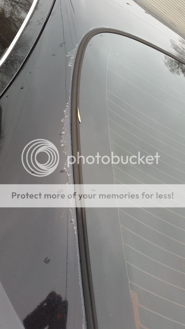

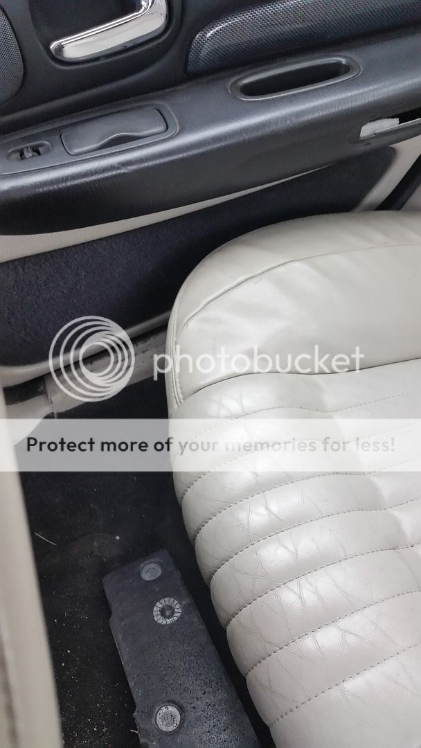

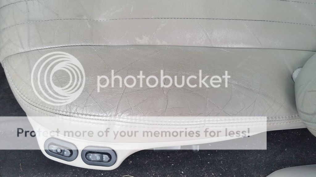

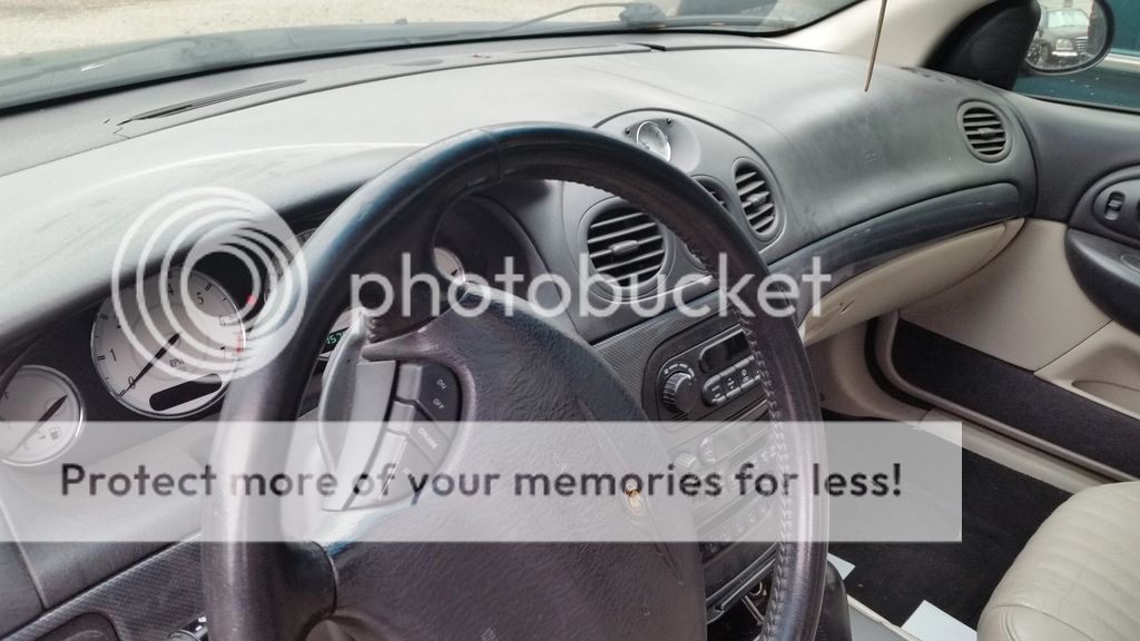

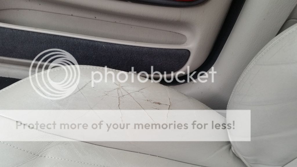

Body-wise, it's looking pretty good. There's some clear coat issues around the rear window and a few minor scuffs, but I have yet to find a single hail dent or door ding. Interior . . . . could use a good cleaning. The seats aren't torn but have some wear. I'm thinking about swapping out the shifter bezel and cupholder with slate (cupholder being the molded style) and a slate leather console lid. Maybe repaint the plastic pieces at the bottom of the door, or swap them out for slate. I think I've got a good candidate for resurrection, either engine swap or engine rebuild.

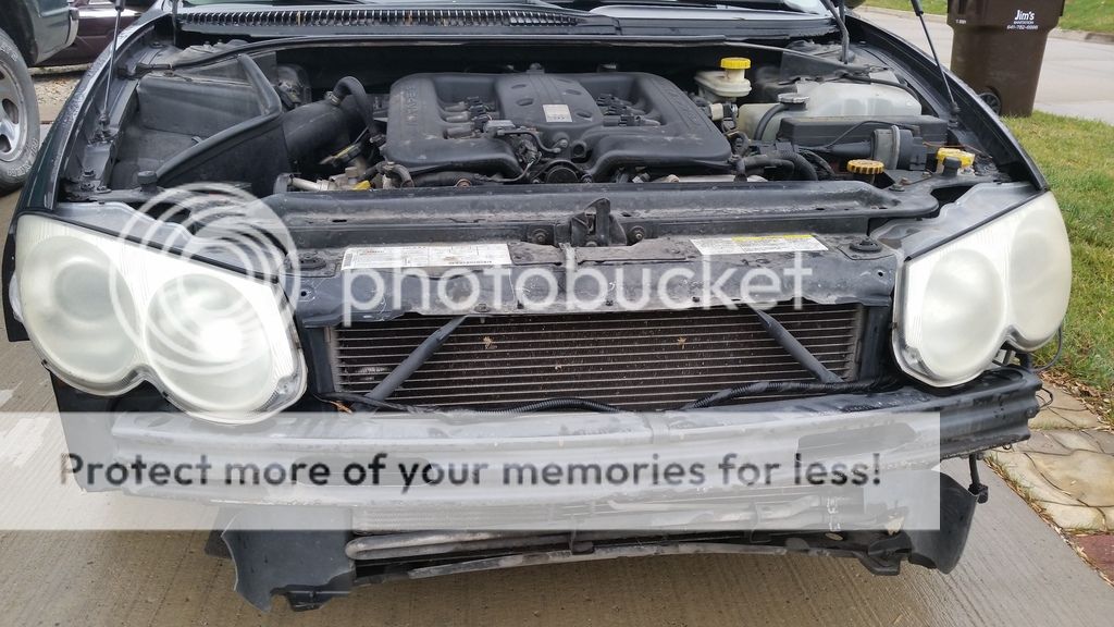

Got started on it before work today.
Click on the photo to view the video.
I guess it's possible that the waterpump might not have too much resistance to turn when rotating the engine by hand vs when running at idle and may still be the cause of the squealing noise if the belt is slipping on it, but I am not making any bets on it. Can't take the belt off for better inspection until I have the torque converter bolts out.

For what its worth, In my experience with these 3.5L engines, when a rod bearing goes you get a knock for some period of time and then it seizes up hard as you have steel rod and steel crank. With a main, they tend to break off the tang on the bearing and spin in the block as they weld to the steel crank and spin in the aluminum block. I find that most of these will start and run at idle, but will have no power if put in gear to try to move the car. Don't let them run too long this way as the oil to the upper end of the engine is dependent on the oiling holes in the main bearings being in the right place.
