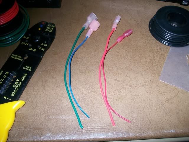

A quick comparison shot of a pair of Bill's puttstick wires that come with to the ones I'm making up. I'll explain this more in a little bit.

As far as why I'm redoing a lot of Bill's work, it has nothing to do with what he did being poor quality. I have slightly better tools for the job than he did (we have identical soldering equipment but I've got the ratcheting crimper) but that is a minor factor. Really it has to do with Bill designed the install to be simple enough for any car enthusiast to manage. Wiring is my profession, so I wanted to do things to a slightly higher standard. No T taps going anywhere in this install, its all soldered wires into the factory harnesses and then well crimped insulated terminals. I had to cut off all of Bill's terminals that he used because all the insulated ones I bought to try were slightly different shape, just enough they wouldn't attach to each other. I ordered 100 of each male and female for just a few bucks so that really wasn't a big deal. Now it all fits together perfectly and is ready to go. I also doubled the length for the valet switch wires, so I chopped off those connectors as well.
I also used 18 gauge hook up wire for all my stuff (the Puttstick wires are 22). 22 is adequate for all the wiring needed, but I went on the top end of what the insulated terminals of that size would hold and also wanted a little stronger wiring for durabilities sake, especially because my puttstick requires wiring into the engine bay where the others didn't. The stuff I have is rated to 176 degrees and in the engine bay its wrapped in electrical tape and will be in the same wire loom (smaller size) that I used for my power wiring project.
