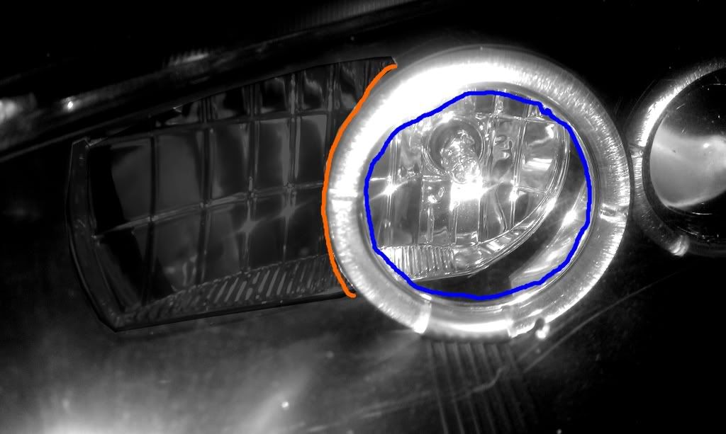

Group, i recently got some spyder headlights from ben (predatoryrtrep). and im liking the projector low beams with the H.I.D.'s. but the high beams are a joke. Because i like the look of the spyders, but the light output is so terrible, I'm going do something about it. heres my idea.
Heres a picture of the stock spyder headlights.
my thought is to cut the inner portion of the reflector (as seen by the orange line) and keep it in place.
then remove the reflector portion from around the bulb completely, with the bulb. ( represented by the blue circle)
once that has been done, retrofit a projector inside the halo, much like the low beam projector setup. for this i was going to use a projector from a 2G LHS high beam, but its hard for me to get a hold of these and im not sure they will fit, i have decided to use 1G LHS projectors. ( to test my theory) or from a 90's model lexus.
if it works out well i will upgrade to better projectors

It's not a bad idea. For a strictly high-beam projector I probably wouldn't want to be using HID's because you switch them on and off often. A better proposition would be bi-xenon projector. Also, while you're in the headlight I would try to modify the standard projector that's in there to fix the cut-off.

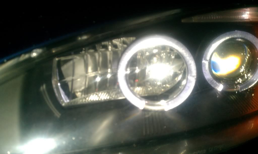

update. i got the 1G LHS projectors installed. the light output wasnt that great so im getting different projectors tomorrow. also probably because i didnt have the shroud because its a part of the 1G headlight.
i figured the light output wasnt good because it was not set-up for high-beam use. so im getting projectors out of a 2001 kia optima tomorrow, they are used for high-beams and should have a better pattern. heres some pics of what ive been doing so far.
