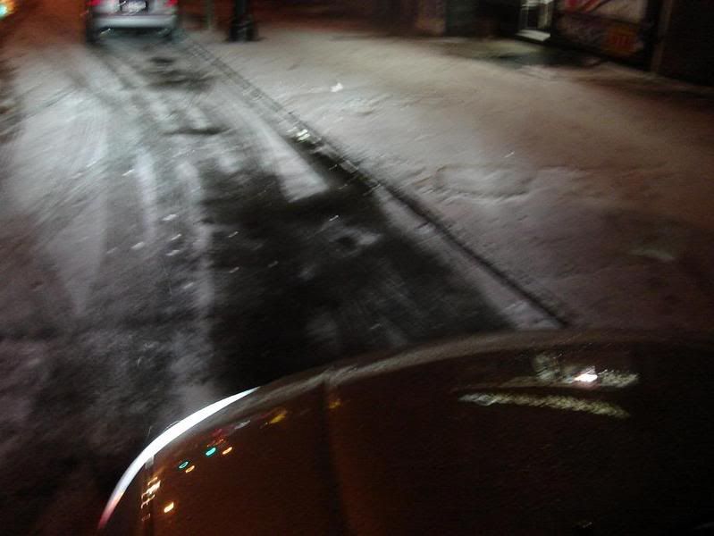

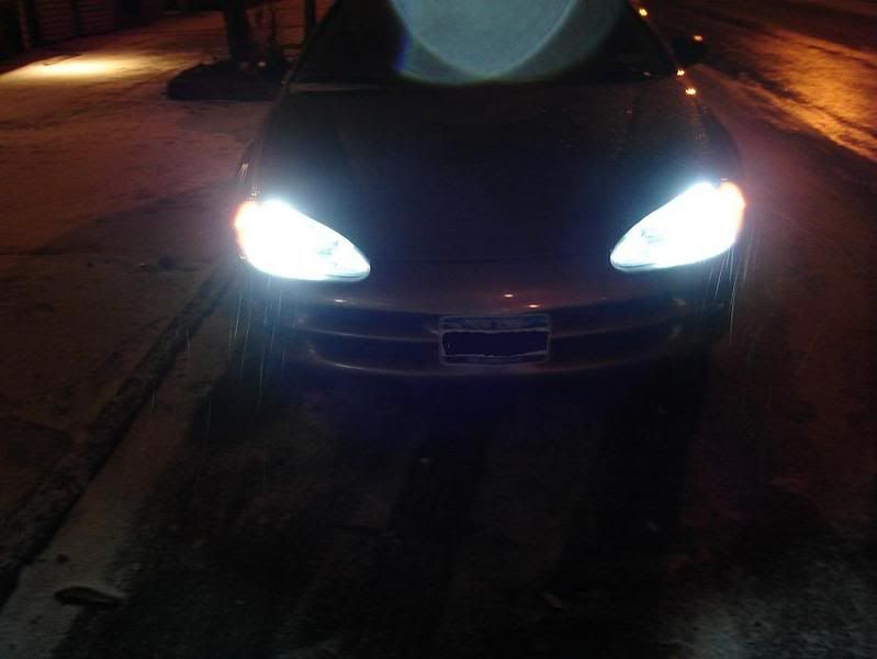

ok here are some pics. tell me what you think
I couldn't really find a proper place to mount the ballasts, I kinda just zip tied them on the frame. I'll take some more pics later of where I mounted them. ok so a queston for you xenoners out there. where would be a proper place to mount them anyway?

call me a noob but what is profuse glare? too bright? well if its that, I did aim the headlights a bit lower toward the ground. and in nyc you need all the light you can get with all these pot holes here...
4,600 Posts
Glare-aroni. It appears in your pic from the front that there is a lot of stray light transmission above the horizontal plane of the headlights.
*For everyone* pictures of the front of your car to show light output or brightness from new headlight mods is USELESS! What you do is show the projected light pattern from different distances like 5-25-50 feet. Kinda like he did in the 3rd picture. It's good to show cutoff too.

Yeah way to much glare thank god your in NY. I prefer mine instead real H.I.D.
Heres a close up of a retrofit theres 3 other member with them and the results far out weigh the price you pay for them 2nd picture is from 50 or so feet away look at the beem patern nice and clean no glare
http://www.danielsternlighting.com/tech/bulbs/Hid/conversions/conversions.html
A coiled metal filament has very well defined dark regions and bright regions.
An arc discharge is a nebulous source of lights (arch shaped due to convection currents)
They are not interchangeable. Projector headlights have the cutoff defined by the shield, so HID retrofits isn't very bad. The light distribution under the cutoff is still wrong. But putting projector HID capsules in reflectors is the worst possible setup.
Did the person who sold you these even give you D1R/D2R vs D1S/D2S?
I still think ALL arc discharge headlights should be required to have dynamic auto leveling and cleaning systems, retrofit or no. Hella sells a rear ultrasonic detector to determine the change attitude, with their kits.
